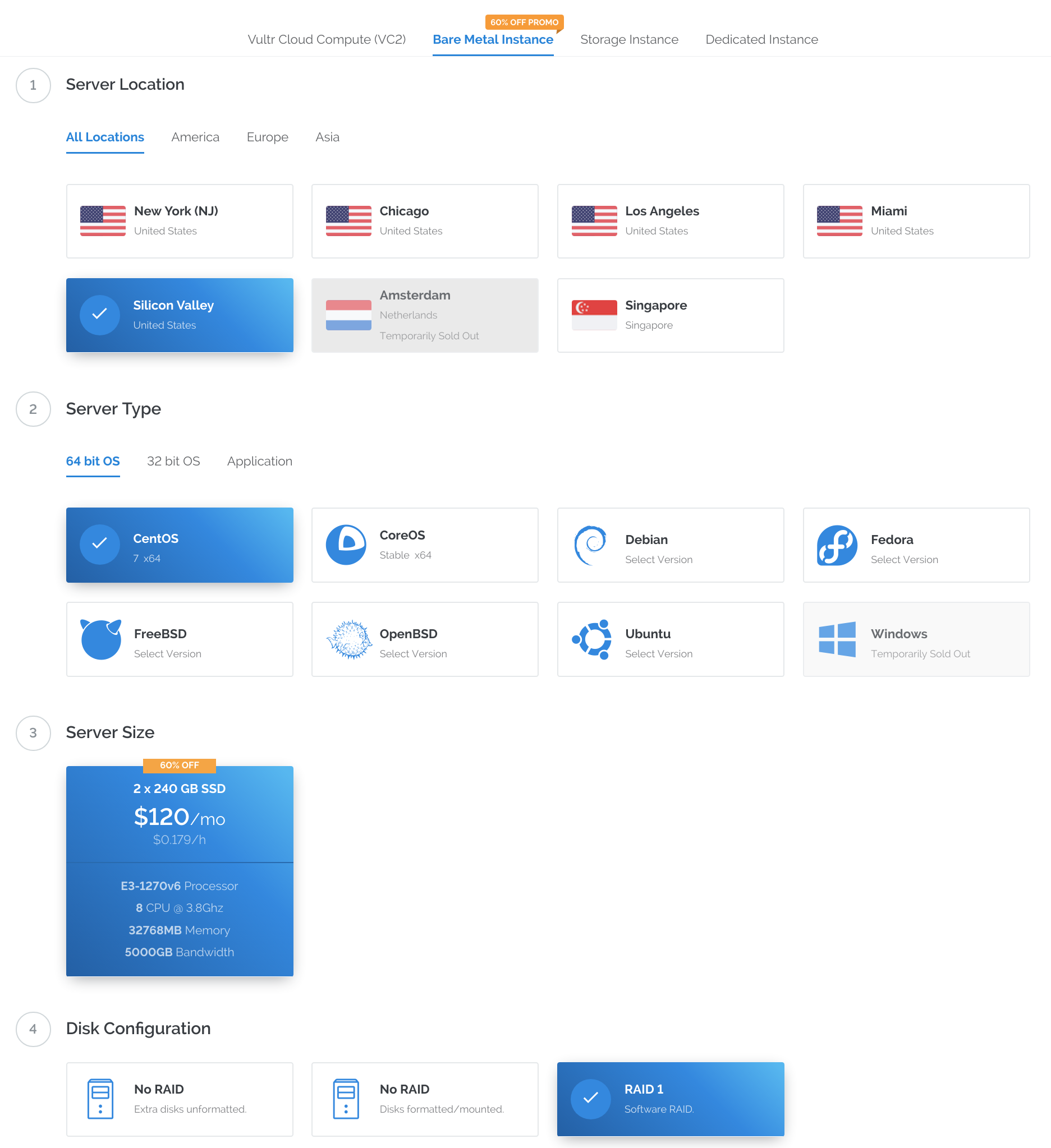

Create Vultr Server
Select Bare Metal Instance and set the Server Type to CentOS 7. Then add an SSH key and click Deploy Now. Repeat this for the number of Pritunl Cloud hosts that will be deployed.

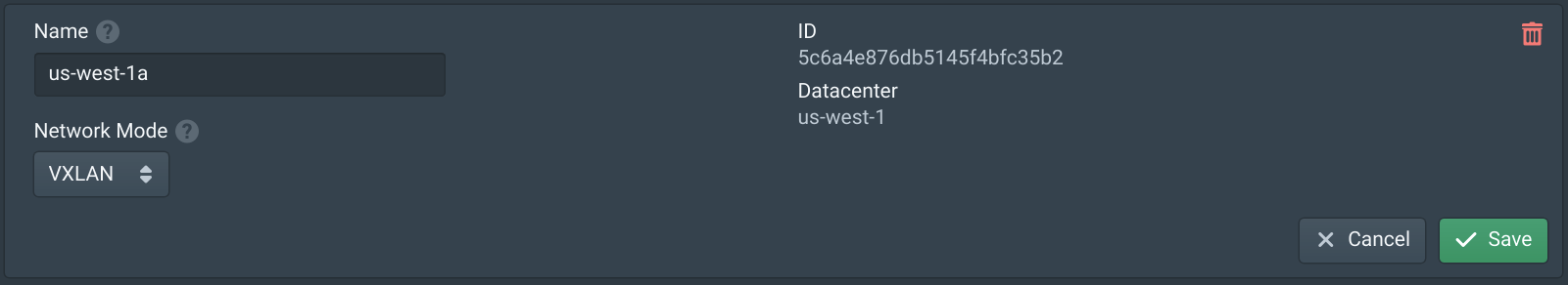

In the Zones tab click New and set the Name to us-west-1a. Then set Network Mode to VXLAN and click Save.
1601

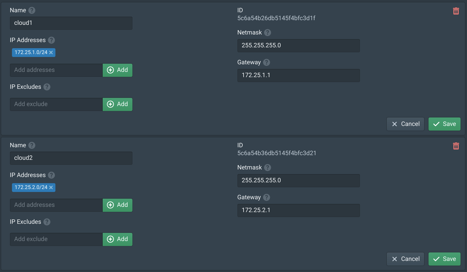

In the IP Blocks tab click New and create an IP Block for each Pritunl Cloud server. Below is an example of three server blocks. These IP blocks will be used to create a host network on each Pritunl Cloud server for Pritunl Cloud instances.
  • IP Block 1
  • Name: cloud1
  • IP Addresses: 172.25.1.0/24
  • Netmask: 255.255.255.0
  • Gateway: 172.25.1.1
  • IP Block 2
  • Name: cloud2
  • IP Addresses: 172.25.2.0/24
  • Gateway: 172.25.2.1
1601

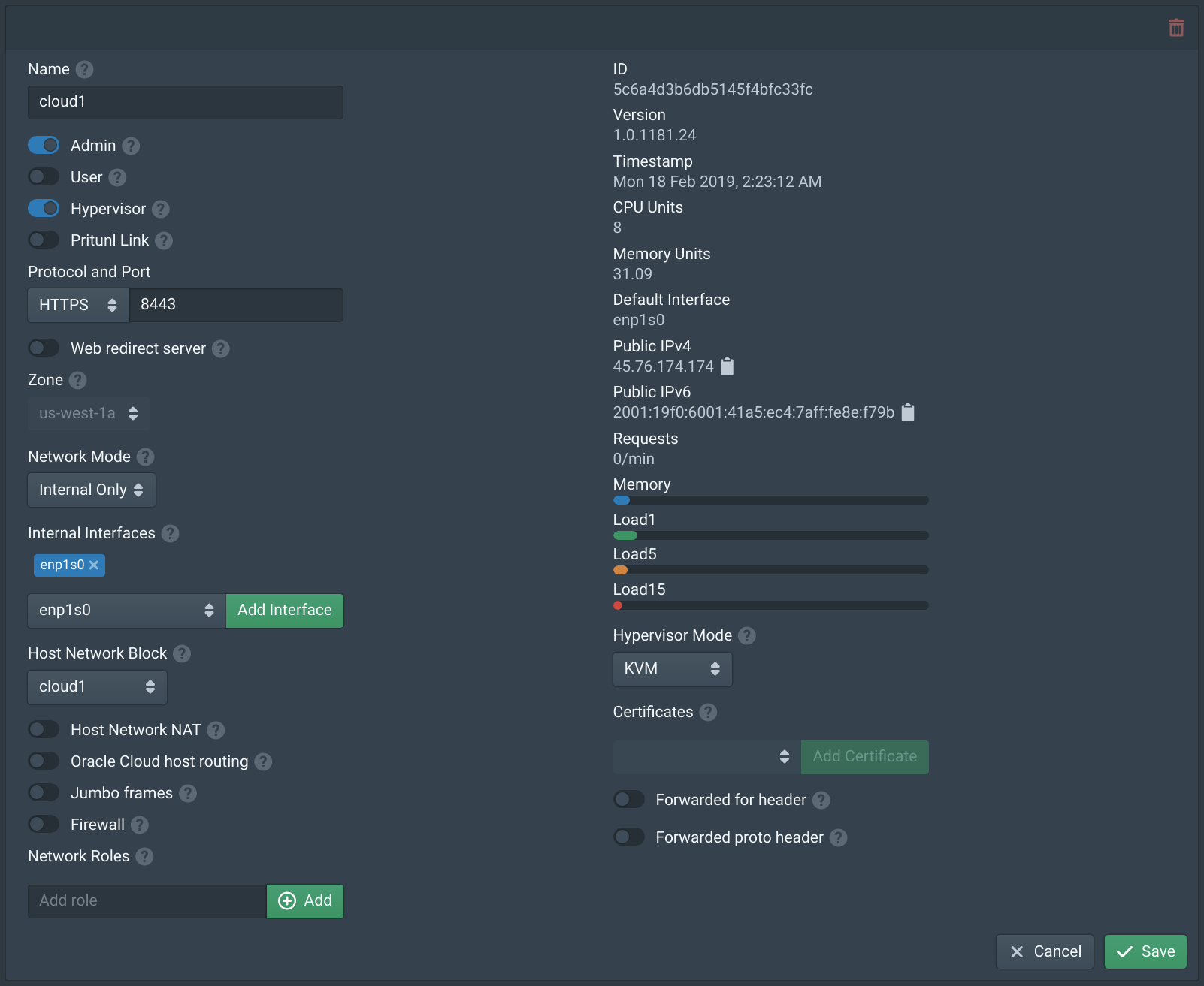

In the Nodes tab configure each node using the parameters below. Each node needs a unique host network block. Although a host network NAT will be used it will be managed by FirewallD and should remain disabled in Pritunl Cloud.
  • Node 1
  • Name: cloud1
  • Zone: us-west-1a
  • Network Mode: Internal Only
  • Internal Interfaces: enp1s0
  • Host Network Block: cloud1
  • Node 2
  • Name: cloud2
  • Zone: us-west-1a
  • Host Network Block: cloud2
1597

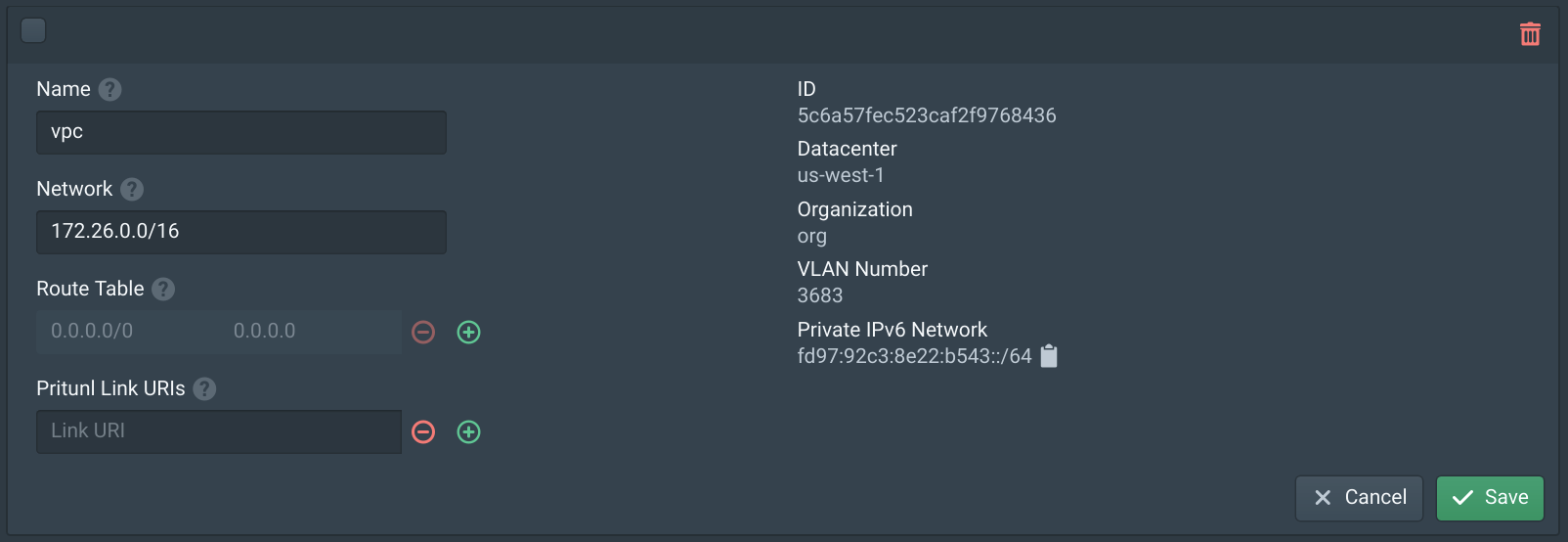

In the VPCs tab enter 172.26.0.0/16 in the network field and click New. Then set the Name to vpc and click Save.
1604

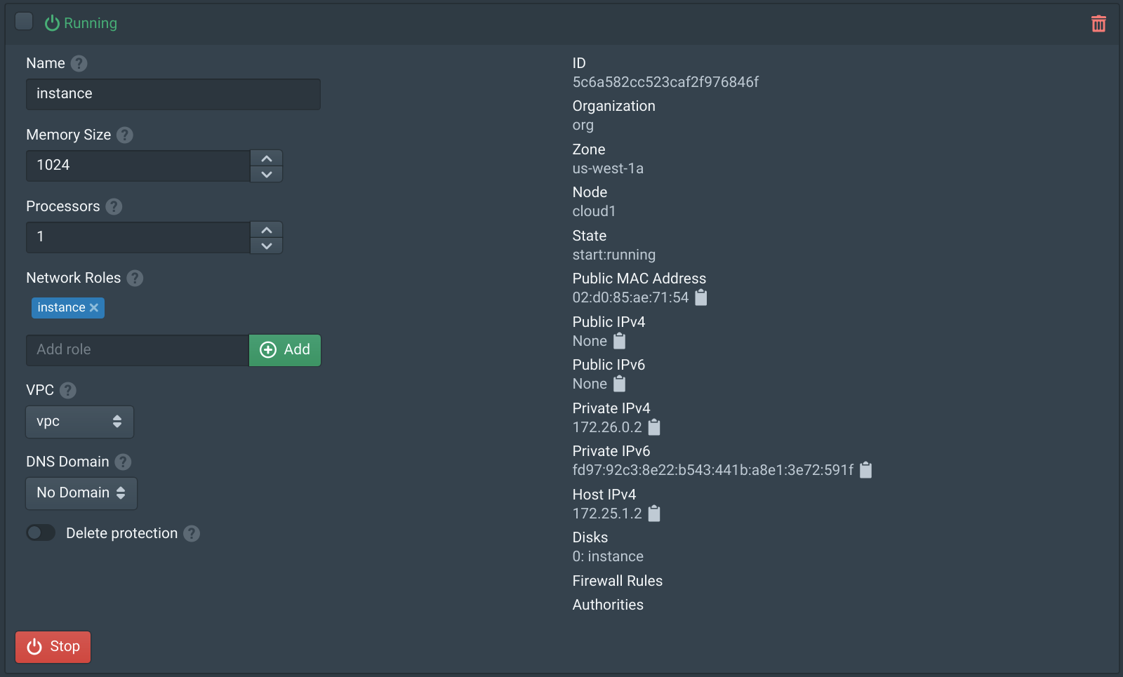

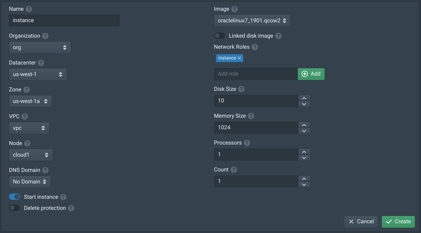

In the Instances tab click New. Set the Name to test, set the Datacenter to us-west-1, set the Zone to us-west-1a and set the Node. Set VPC to vpc. Add instance to the Network Roles and set the Image to oraclelinux7_1901.qcow2. If no images are shown click the Sync button on the Storages tab. Repeat this and create a second instance on a different node to test VPC networking.
1599
Run the command ssh -J cloud@<vultr_server_public_ip> cloud@<pritunl_instance_host_ip> to access the Pritunl Cloud instance through the Pritunl Cloud host.
