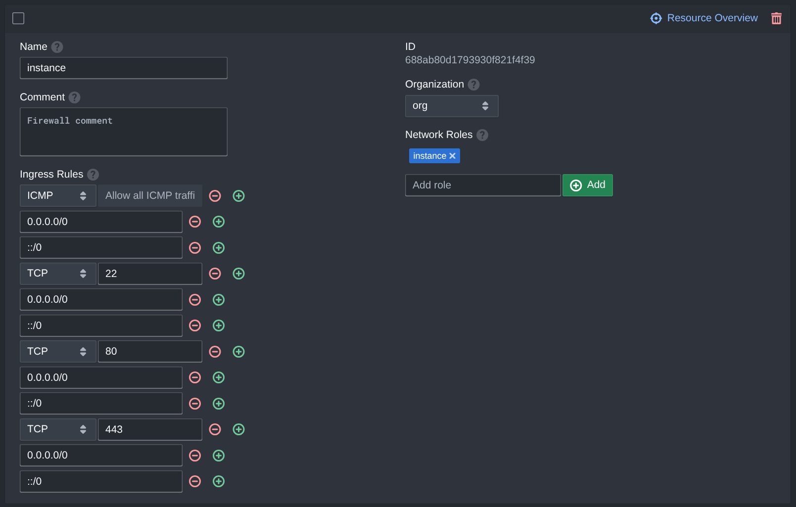

### Default Instance Firewall
Below is the default firewall that is created on installation. To apply this to an instance include the `instance` role when creating the instance. This includes the following rules.
22/tcp - SSH
80/tcp - HTTP
443/tcp - HTTPS
<figure><img src="https://1205480171-files.gitbook.io/~/files/v0/b/gitbook-x-prod.appspot.com/o/spaces%2F7VFD0Okoikbws6fRiMFC%2Fuploads%2FmG2Ttfpycy8oRTeVxL2H%2Fcloud_instance_firewall.png?alt=media&amp;token=558b53da-b866-4bb0-924a-e27e5eb4e66a" alt=""><figcaption></figcaption></figure>
