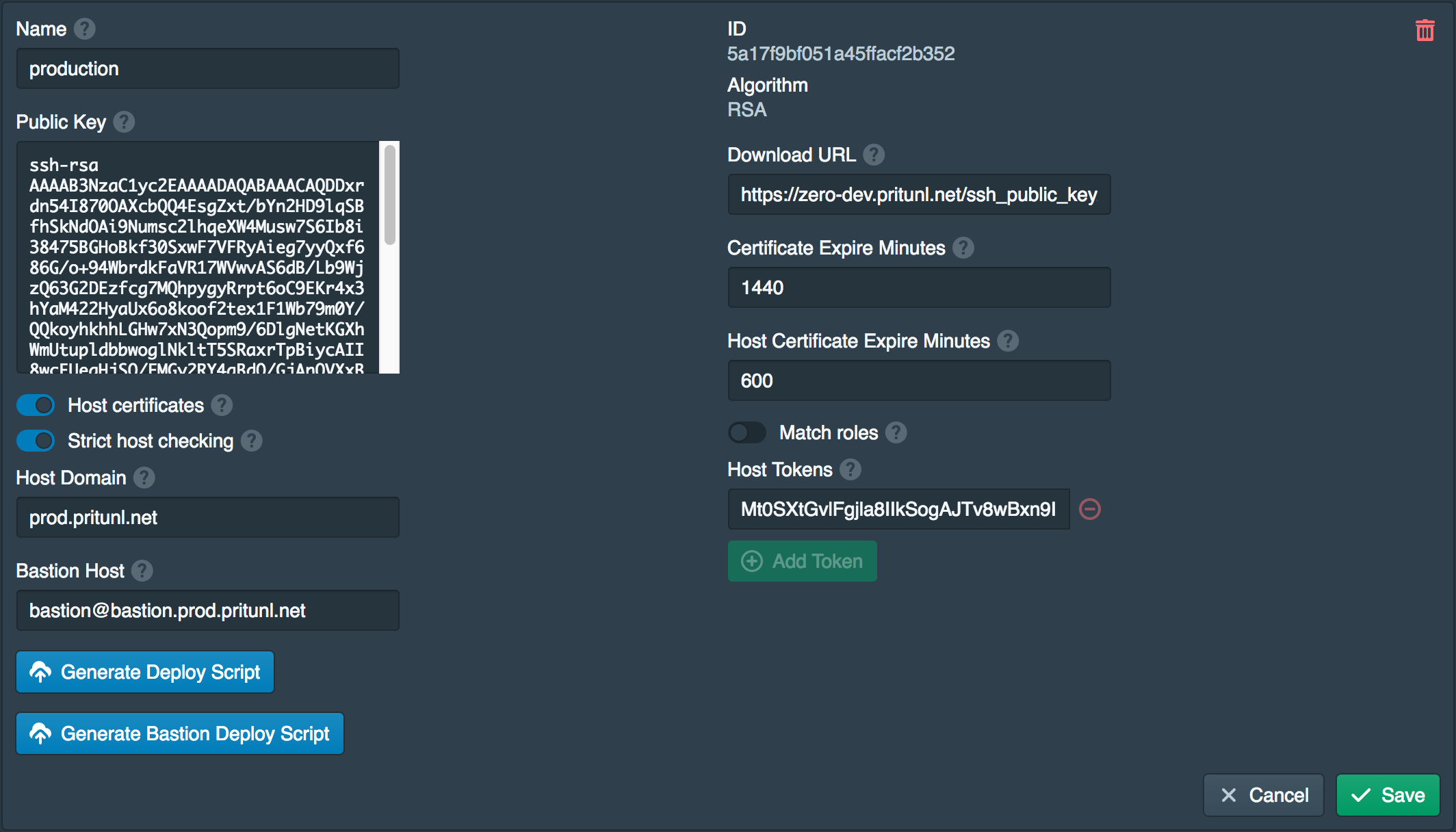

### Configure Authority
After the new hosts have been added to the Pritunl Zero cluster go to the Authorities tab and enable Automatic bastion server. Then enter the hostname that will be registered to the AWS load balancer, in this example `bastion.pritunl.net`. Enter the SSH bastion port `9800`. Next add the subnet or subnets that this authority and bastion server will be providing access to. In this example the bastion servers will be providing access to the VPC subnet `172.31.0.0/16`. Any connections a user makes to a matching subnet will be proxied through the bastion server. This will prevent the user from accessing local subnets if there is an overlapping subnet. Currently only /8, /16, /24 and /32 subnets are supported. If access to multiple VPCs are required either VPC peering can be used or multiple authorities each with a different bastion server can be configured. When creating multiple authorities a different bastion port should always be used. Authorities can be made selectively available to users with the Match roles option, this will only provide access to and configure the authority if the user has a matching role.
<figure><img src="https://2374617543-files.gitbook.io/~/files/v0/b/gitbook-x-prod.appspot.com/o/spaces%2FlsTNjQ8Kdr13MwZnI3jV%2Fuploads%2FCpxVbO9sWNAqwuUEDayu%2Fbastions7.png?alt=media&amp;token=7b69aa03-6077-494d-87e7-19a9640db6eb" alt=""><figcaption></figcaption></figure>

SSH certificate authorities support strict host checking to ensure a users connection to a server is the correct server and prevents man-in-the-middle attacks. This is similar to how web browsers verify a connection to a domain with a SSL certificate. This is often very difficult to deploy and requires every server has an agent to request the SSH host certificate from the certificate authority. Pritunl Zero supports this with the Pritunl Zero SSH Host client. One of the benefits of the automatic bastion server is host certificates with strict host checking will always be used for the bastion server regardless of the authorities configuration. Even if the authority has *Host certificates* and *Strict host checking* disabled a users connection to a Pritunl Zero bastion server will always use strict host checking with a host certificate. This makes the deploying host certificates mostly unnecessary as the connection from the user to the VPC network will be secured and verified with the bastion host certificate check. An internal SSH connection between the bastion server and a server on the VPC will not be prone to man-in-the-middle attacks.
