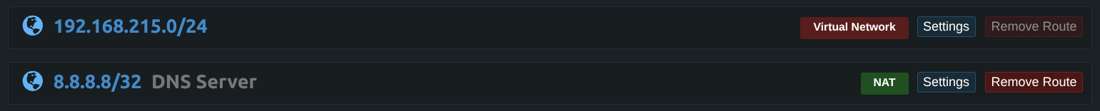

### DNS Issues
Some VPN connections will require the DNS server to be routed through the VPN. This will depend on the protocol and client version. If a route for this is not available DNS resolution on the client will fail. Servers are created with the default DNS server 8.8.8.8 and a route 8.8.8.8/32 for this DNS server is also created. If the DNS server is changed or the server was created in an older release that did not create a default route one should be created. This can be done by adding the DNS server IP addresses with a /32 subnet such as 8.8.8.8/32 to the server routes.
<figure><img src="https://1783284711-files.gitbook.io/~/files/v0/b/gitbook-x-prod.appspot.com/o/spaces%2FhDA4eusSNQcv5QfappvI%2Fuploads%2FtJkqh3sdevoCG94ZHwUO%2Fpritunl_dns_route.png?alt=media&amp;token=150de23a-42d2-414d-acdd-6759a8614dd9" alt=""><figcaption></figcaption></figure>
